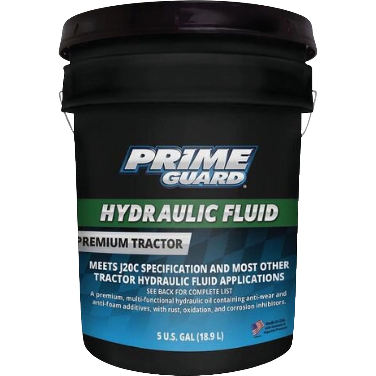

Make sure at wot the tv is pulling the valve open all the way when you have the pan off. Probably need a helper to see or push the pedal down.
I had a guy on tb.com post he used this so I bought a pail full and put it in. So far so good. Why you ask? It was cheaper than trans fluid. I did say I am on a budget. It doesn't smell burned and hasn't gotten discolored yet.
If you have the budget n micale pushes dex vi. If my budget wa unlimited I'd give it a whirl but I'm pretty happy with the coastal stuff so far.

Jake up in Sanger recommends the low viscosity John Deere Hy Guard and one quart of your flavor of red transmission fluid so you can read the dipstick.  It's pricey...

Yeah, that's why I bought the multiviscosity as I drive it year round. I looked at hydraulic fluid and there were three viscosity levels that I found with 32 being the thinnest. Also that jd in high n low, and the stuff case ih uses with a 303 in the name. I just chose the coastal stuff because the guy on tb.com said it worked for him. And it was about $50 at the local AutoZone for 5 gallons. Cheaper than a gallon of trans fluid at wally world.
I have read that the b&m trickshift is very similar to type f but that is just hearsay.
I think as long as it isn't getting too hot pretty much anything will work.
