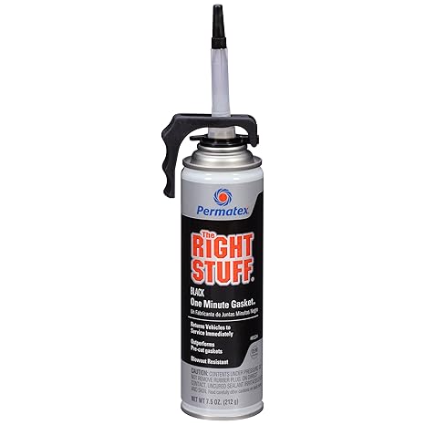

I've noticed that some modern engines don't use gaskets as they are usually the weak spots in the assembly.  Rather they use various formulations of rtvs.
I'm sure that Earl will catch flak for his use of Rightstuff to seal an oil pan to the block, but, I doubt he plans on removing the pan any more frequently than a manufacturer does and the elimination of leaks overrides the extra effort required on removing the pan somewhere in the future.

The Right Stuff is a dream come true!  Love it!

Quote from: Steve Wood
 "it worked 50 years ago, why should I change"
And THAT'S why detergent oil blows up engines!!!   :D
Oh, I've caught all kinds of shit over it.
   Luckily for me, I've removed my pans quite a few times before I learned from the internet experts that I couldn't do it.
   But neither my Buick or my 454 jetboat leaks oil (and my pickup depths are set to the correct curtain area), so what do I know?
