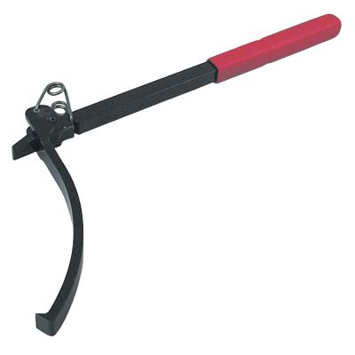

http://m.northerntool.com/products/shop~tools~product_200640984_200640984?hotline=false
Trans jack. Makes stabbing way easier. Tilts side to side and front to back. Worked great for getting it stabbed.
Also a flywheel turner. Way better than busted knuckles.
No shift cable so you don't have to worry about that. Pull the tv cable so it doesn't get damaged. Get a three foot extension to do the bell housing bolts from below., i like an impact universal or some electrical tape on a regular universal joint to stiffen it up, floppy joint is annoying.  Bend the pinch weld out of the way while the trans I out for next time. Maybe some new u joints while you have the drive shaft out. Make sure the converter is seated all the way. Have plenty of fluid on hand.
