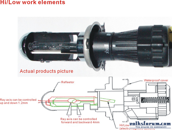

Curious, this Bi-Xenon:
Re: Caspers Headlight Brightener
« Reply #47 on: October 27 2011, 03:14:14 PM »
