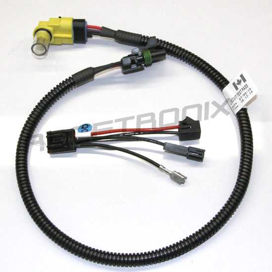

« Reply #29 on: November 09 2015, 09:48:59 AM »
http://www.racetronix.biz/mmWEBSTORE/Images/bcws-g77.jpg
I'm thinking maybe where this connects might be due for replacement as those pins are dinky and it was a connector like this that I replaced that made our suburban reliable(suburban connector was all black and burned looking). Is there a cheaper place to get this connector? $50 seems like a lot but I guess it comes with the wires too. I'll head over to caspers and see what they have. Anyone have another place to look? TIA
