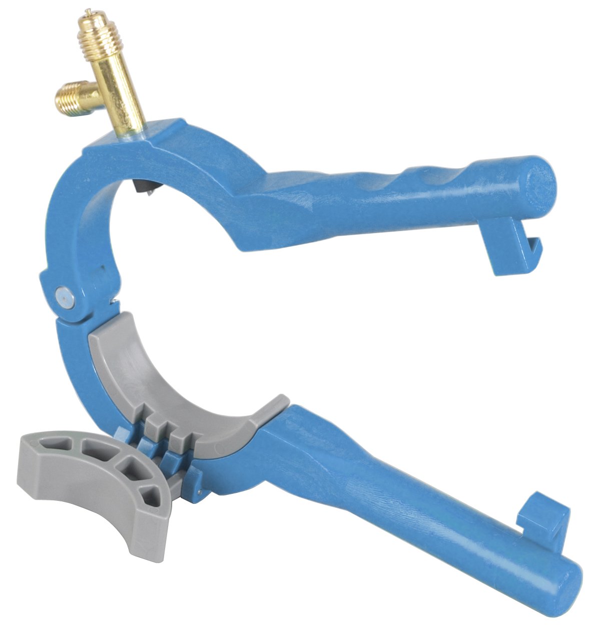

as I am lazy and don't want to read-how do you get it out of the spray can and into a hose?
Re: Office duster/HC152A conversion
« Reply #26 on: August 11 2013, 05:26:35 PM »
Modified side-tap tool.

If you use a side tap use a knife or something to scrape the pain off the side where you want to puncture it. The spike is hollow and can catch some of the paint when it goes through the side. It may not cause a problem but I'd rather not have the extra trash in the system. :chin:

Aren't these the right size?
