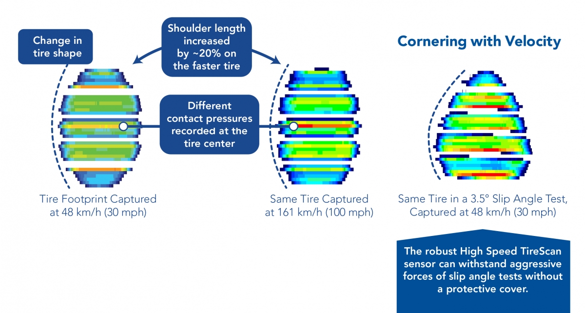

I thought it was common knowledge that the actual contact area was diamond shaped?

  I'm not either.
Motorcyles are skinny ovals.  Car tires stand up in the middle.

Because pneumatic tires are flexible the contact patch can be different when vehicle is in motion than when static.
https://en.wikipedia.org/wiki/Contact_patch
I think we were assuming a specially made drag tire from static.
But yea if you right click on the image you posted and search google for image you get some
interesting stuff.

 Physics are usually pretty picky about who gets to break the laws. Pretty sure drag tires are still subject to centrifugal and centripetal force.
ESP considering they usually have very weak and flexible carcasses.   They aren't built like a $500 low profile performance radial, so they should be much worse with the deformed contact patches.

I'm pretty sure the "deformed" contact patch is the whole point of the drag tire and it's easily manipulated sidewall. Adjusting tire pressure can add and subtract the patch and the " drag" the tire exerts down the track at speed.
